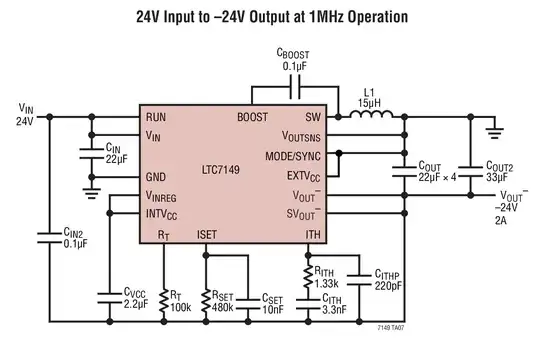

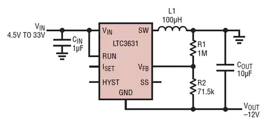

Linear tech produce a number of inverting switchers like this: -
Check the data sheet to see if it can produce -24V. If not then use the search engine on this page here
There's also this one: -
  • No, it can't. Its specification is 45V maximum between Vin and ground. – Oleksandr R. Jul 26 '16 at 10:05
  • @OleksandrR. I did say in my answer to check the data sheet to see if it can produce -24V. Anyway I've added another option. – Andy aka Jul 26 '16 at 10:06
  • Yes, and I checked it and found it's not suitable. The second option is better and I upvoted your answer. I wonder, if not the datasheets, where are you getting these images from? – Oleksandr R. Jul 26 '16 at 10:07
  • @OleksandrR....... enter your search phrase into google then select images from the top line! Is anyone of these pictures you: https://www.google.co.uk/search?q=Oleksandr&espv=2&biw=1241&bih=923&source=lnms&tbm=isch&sa=X&ved=0ahUKEwjTh9LS8ZDOAhWHJcAKHevICcYQ_AUIBigB – Andy aka Jul 26 '16 at 10:09

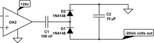

Assuming the -24v is a control input, so doesn't need much current, and only needs approximately -24v, then a cheap, quick and dirty way is to use a charge pump. Like this.
What's drawn as an opamp is any circuit capable of making a rail to rail square wave.
The output is unregulated, and drops with increasing current.
If you do need exactly -24v, then you can use a 2 stage charge pump and regulator.
If you need more current than a few mA, then it's worth going to a magnetic solution, an inverting boost, rather than a charge pump.

  • It takes an oscillator to drive "OA2", and diodes D1 and D2 are reversed. As shown, this would generate positive 24V. – Whit3rd Jul 26 '16 at 19:42
    OA2 could *be* the oscillator, that's not a full circuit of course. Diodes the wrong way round ... I'd like to say 'congratulations, you're the first to spot my deliberate mistake', but I must actually say 'doh! facepalm'. – Neil_UK Jul 26 '16 at 20:12
