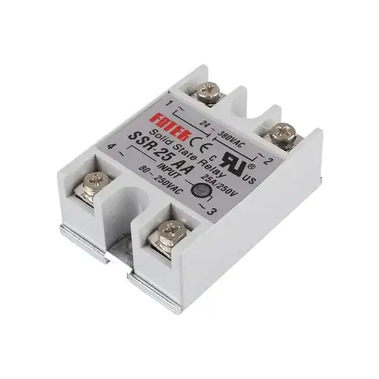

  • @stib WARNING there are a huge amount of counterfeits (fakes) of that specific SSR. You have to be careful which one you buy. Take a look at UL's warning: http://www.ul.com/newsroom/publicnotices/ul-warns-of-solid-state-relay-with-counterfeit-ul-recognition-mark-release-13pn-52/ – Bradman175 Jul 25 '16 at 03:17
  • @stib That one you suggested on eBay is FAKE! It doesn't have the corner cut correctly. So there would be a LOT of safety issues, where it could just break when unexpected. – Bradman175 Jul 25 '16 at 03:20

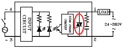

That should work for you depending on the details of the internal circuitry. There is a zero-cross detection circuit built into the output so it can only turn on as the mains voltage crosses the zero line and this minimises electrical interference from the switching. Since the input is powered from AC and is most likely on the same phase the "input circuit" must rectify and store enough charge to keep the LEDs on through the zero-cross.
The problem, however, is one of safety. The SSR (solid-state relay) uses a triac as the switch.
Figure 1. Innards of the AA (AC/AC) version Fotek SSR with the switching triac highlighted.
The problem with any semiconductor device in a safety critical circuit is predicting failure modes. In general you can't: the triac in this case could fail open circuit (safe) or short-circuit (unsafe). There are ways around this but they are not simple in a power circuit such as yours.
A second problem is that triacs can be erroneously triggered by a sudden change in applied voltage (a mains transient or restoration of mains power while at its peak) across its terminals even without any trigger voltage. This may be listed as maximum \$ \frac {dV}{dt} \$ that the device can stand before turning on. In normal circumstances this would cause the triac to conduct for one half-cycle and this might be harmless. (You wouldn't see a lamp blink, for example.) In your case, since you have a latch the circuit might remain on and start the motor.
Using an SSR for a safety-critical device is not recommended. Relays with air-gaps are far safer. You could add it in series with a mechanical relay to solve the "whack" problem but then you really need to think about cycle-testing the device on each use. i.e. Some means of detecting that the SSR has stuck on. Indicator lamps might be sufficient.

    @transistor "Using an SSR for a safety-critical device is not recommended" especially when the OP is buying a counterfeit! – Bradman175 Jul 25 '16 at 03:27
Do NOT use Fotek solid-state relays from eBay or Amazon. All of them are counterfeit. See this Underwriter's Laboratories warning notice: http://www.ul.com/newsroom/publicnotices/ul-warns-of-solid-state-relay-with-counterfeit-ul-recognition-mark-release-13pn-52/ Not one picture of a Fotek relay on eBay or Amazon matches UL's picture of an approved relay. Most of the fakes fail at much lower current levels than their markings would indicate, and sometimes they fail in the ON state.
