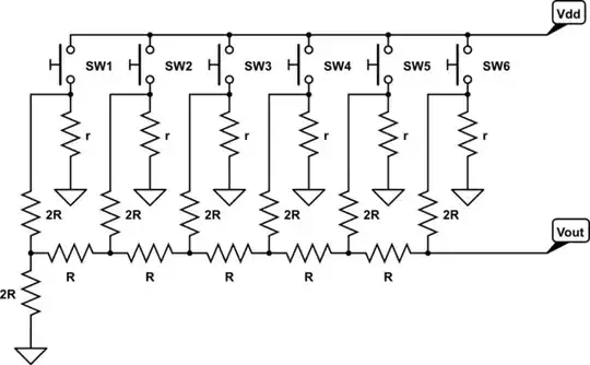

You could use the good, old, R2R DAC:
All r should be small enough wrt to R to pull down the push button output when it is released. Some good values you can start with are:
  • \$r=1k\Omega\$
  • \$R=47k\Omega\$
  • \$2R=100k\Omega\$
Better yet, use one \$100k\Omega\$ resistor for R and two of them in series for the 2R resistor.
I will not dig in how this circuit works, refer to wikipedia for an explaination, what you want to know is that if we associate a digital number to the push button states, the output voltage is an analog representation of such number.
If the button is pressed, we say it is 1, if it is not pressed we say it is 0. SW1 is the LSB, i.e. the rightmost bit, while SW6 is the MSB, i.e. the leftmost.
As an example, if you press SW6, 3 and 2 the digital number is \$D=100110\$, which in decimal is 38.
The output voltage depends on \$V_{dd}\$ and is: $$ V_{out}=V_{dd}\frac{D}{2^N} $$ where N is the number of switches, in this case 6.
You can sample the analog voltage with the arduino ADC and then convert it back to a digital representation of the status.
Since you have an eight bit converter, the routine will be pretty neat:
uint_8t sw_status;
while(1) {
  sw_status = adc_read() >> 2;
  // do something with sw_status. the lsb represents SW1, and so on, e.g.:
  if (sw_status & (1 << 3)) {
    //SW3 is pressed here!
There are some problems with this. First of all, you need precise resistors, or you will get non monotonic behavior which is very bad. The ADC on the nano should be precise enough, but you need to check if it accepts rail to rail inputs. And you get some error because you do not have SPDT push buttons, and you need to use the pull down. Moreover, if you have long wires going to the console, you will probably need to buffer the signal to avoid spurious reads.
All in all this works, requires not many components but is suboptimal at the least. I would definitely go for i2c IO expanders. But this solution is pretty neat and a bit out of the box, and deserves some evaluating.

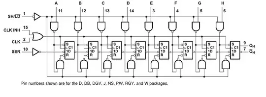

The classical approach here is to use some kind of IO extender IC. In the simplest case, this would simply be a parallel-to-serial-shift register, for example some variant of the 74xx165:
shift register SN74LV165
The picture is from the Texas Instruments SN74LV165A datasheet.
The idea is the following: When the SH pin is pulled low, the values at pins A-H are stored in the internal flipflops, so this is where you connect your switches/buttons that either connect the pin directly to supply voltage (if pressed, for example), or ground the pin throug a (largish) resistor:
That way, when the button is pressed, the voltage at the input is "high", otherwise it's low. It's usually recommendable to connect a capacitor in parallel to the resistor, because that will counter so-called "bouncing". The actual resistor and capacitor values aren't critical – if you use a resistor value that's too small, you'll draw a lot of current with every button pressed, and if you choose a capacitor value too large, buttons will appear to take a long time until they are effectively pressed and released, but in general, something like 10kOhm and 10nF – 100nF, values abundant in most part boxes, should do well for human interaction.
Yet another hint: if you need to go shopping for parts, buy so-called resistor networks; for example, there's parts that contain 8 identical resistors that have one common pin (which you'd connect to ground here, and 8 individual pins. That way, you save yourself a lot of soldering work, and your circuit can look very clean and tidy.
Now, having pulled SH "high" again, the input values are stored in the flipflops.
Now your microcontroller would start to send a clock signal (high,low,high,low,…) to the CLK input. At every rising edge (i.e. low-to-high transition), an input value appears at QH, and the internal states are pushed one step "to the right", meaning that the second flipflop then contains the old value of the first, the third flipflop the old value of the second and so on. After six clock cycles, all the 8 input values have been sequentially shown on QH. That's why this shift register is usually also called a parallel to serial converting shift register.
You can actually daisy-chain those: if you take a second shift register and attach its QH to your shift register SER input, then the output values will be "concatenated" to your first shift registers values. That way, with only three pins on your Arduino (one pin driving SH, one pin driving CLK, and one pin reading the serial output from QH), you can have virtually unlimited amounts of buttons – and that at a unit price of less than 20ct per 8 inputs
The only limiting part is that you regularly have to pull down SH, pull it back up, and generate 8*(N_shiftregisters) clock cycles; this has to be done often enough not to miss a key press – but usually, with microcontrollers running at MHz's, and with SPI hardware that actually is meant for nothing different than talking to such shift registers, this isn't a problem at all – it's not uncommon to see someone query shift registers a couple thousand times per second.

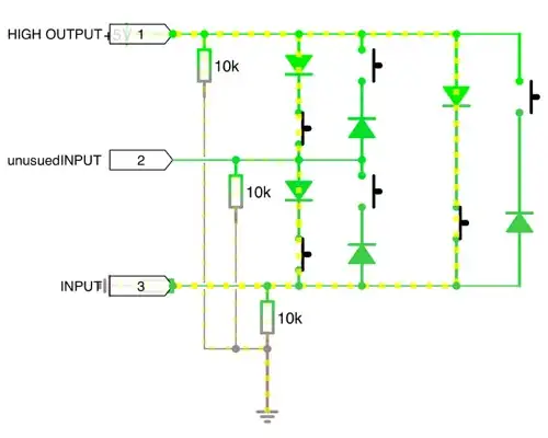

If you have 3 I/O pins, you could charlieplex them.
Charlieplexing
(You should add a pull down resistor before each I/O pin.)
Image source: http://www.pcbheaven.com/wikipages/images/charlieplexing_1302615143.jpg

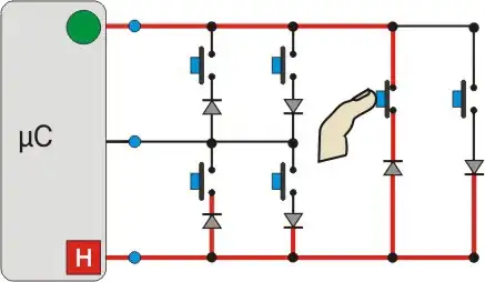

Now as a note, you have to test all the possible combinations (6 in total) before determining which buttons are pressed and which ones are not. If you activity one pair of pins and find that there is continuity, there are three possibilities, where current could flow through two pressed down buttons (kinda in series), one pressed down button or all 3.
This is what I mean: enter image description here
Also, ensure you DO NOT set any OUTPUT to LOW. If you want to prevent something from burning, put like a 1kΩ resistor at each terminal. But that would unintentionally create a voltage divider.

  • I think you need to have pull-downs on the inputs to not have floating inputs when none of the buttons are pressed. ATmega has internal pull-*ups*, though, so you could invert the logic and enable pull-ups on all but one pin at a time, and drive that one pin *low*. (Without using external pull-up/pull-down resistors) – ilkkachu Jul 23 '16 at 12:17
  • @ilkkachu Oh wow thanks for telling me that I will edit the question. – Bradman175 Jul 23 '16 at 12:29
  • I'm going to ask a silly question. Will the internal PULLUP accidentally power the circuit? – Bradman175 Jul 23 '16 at 12:38
  • the pull-ups should pull the pins high, except for the one actively driven low or the ones connected to the low pin via the switches and diodes. There isn't really anything to be powered in that circuit, and the pull-up is weak anyway. You'd just need to interpret a high value the default and a low value the signal for a button press. (And also consider that the current through the diodes would be inverted too.) Other than that, I don't think it should matter if you have a pull-up or a pull-down. – ilkkachu Jul 23 '16 at 12:58
