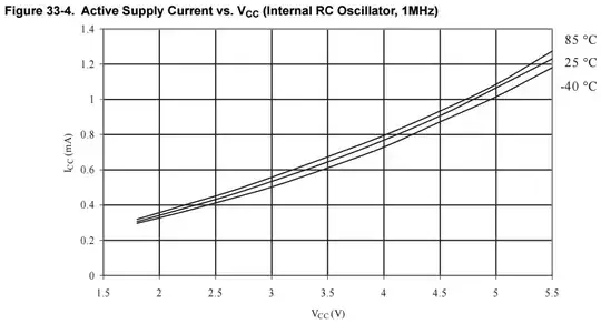

What is the relationship between voltage and the power consumption? I understand that DC power is defined by W = VI, however, if I were to operate at 3.3V, wouldn't I pull less current? I'm not sure if that is a correct assumption however.
Transistor-based ICs generally draw less current at lower voltages; you could approximate them as a resistive load (which is not quite accurate but fair enough for an estimate). Again, the datasheet has a helpful graph (same section):
328 active current vs vcc
As you can see, the relationship is even stronger than linear, it has a slight quadratic curve to it. At 5V it draws about 1mA, for 5mW power. At half that, 2.5V, it's only 0.4mA, resulting in 1mW power. Low voltage is a must if low power is your goal!
