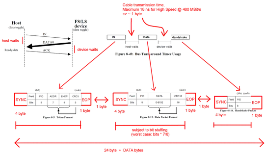

Framing
USB high speed communication is synchronized in a fixed frame structure. Each frame is 125 us long and begins with an Start-Of-Frame packet (SOF) and is limited by and End-Of-Frame sequence (EOF). Each packet starts with SYNC and ends with and End-Of-Packet (EOF). Those sequences have been added to the diagrams for clarity. EOP is variable in size and packet data dependent, for SOF it is always 5 bytes.
enter image description here Open image in a new tab to see a larger version.

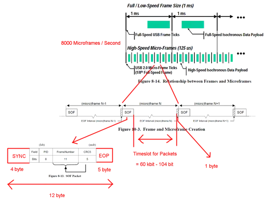

Transactions
USB is a master driven protocol and each transaction is initiated by the host. The timeslot between SOF and EOF can be used for USB transactions. However the timing for SOF and EOF is very strict and the host initiates only transactions that can be fully completed within the free timeslot.
The transaction we are interested in is a successful bulk IN transaction. The transaction starts with a tocken packet IN, then the hosts waits for a data packet DATA0/DATA1 and confirms the transmission with a handshake packet ACK. The EOP for all these packets is 1 to 8 bit depending on the packet data, we assumed the worst case here.
Between each of these three packets we have to consider waiting times. Those are between the last bit of the IN packet from the host and the first bit of the DATA0 packet of the device and between the last bit of the DATA0 packet and the first bit of the ACK packet. We don't have to consider any further delays as the host can start sending the next IN right after sending a ACK. The cable transmission time is defined to be maximum 18 ns.
A bulk transfer can send up to 512 bytes per IN transaction. And the host will try to issue as many transaction as possible in between the frame delimiters. Although bulk transfer has low priority it can take up all of the available time in a slot when there are no other transaction pending.
To ensure proper clock recovery the standards defines a method call bit stuffing. When the packet would require a very long sequence of the same output an additional flank is added. That ensures a flank after a maximum of 6 bits. In the worst case this would increase the total packet size by 7/6. The EOP is not subject to bit stuffing.
