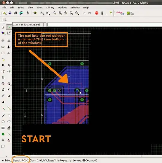

I had a similar problem. Be sure to have the termals named as your ground plane in schematic. You could do this by hand in board view.
This was the solution in my case.

  • How do I verify the terminals are named ground? I have made sure the wires connected to the pins are labeled ground (I would also think that the first image of the vias being thermals with the ground plane would confirm that is the case in the first image) – mightymouse3062 Jul 19 '16 at 17:23
  • @mightymouse3062, you can check the name with the command "Info" (button "i"). Then you can rename with command NAME. I'll add a picture to better explain. – Antonio Jul 20 '16 at 08:08
  • Thank you for the help. This was what I needed to be able to get it working. Also, a comment made [here](http://www.lucidarme.me/?p=1713) helped explain it as well. – mightymouse3062 Jul 22 '16 at 22:02
