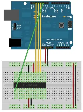

If you just want to use your chip as a replacement Arduino and program it using the Arduino language (which is C++ by the way, not C), you can easily do this using your Arduino with the ArduinoISP sketch. You need to hook up your chip to the Arduino in a specific way, and then you should be able to burn the Arduino bootloader to it using ArduinoISP. More details are on the Arduino site.
If you want to program the AVR as a stand-alone unit, you'll need to program it using ISP for the main program. You can also use your Arduino with the ArduinoISP sketch for that, but you'll have to use a programming tool such as avrdude (the actual AVR programming tool that Arduino uses) directly. You don't need a bootloader on your chip for this.
