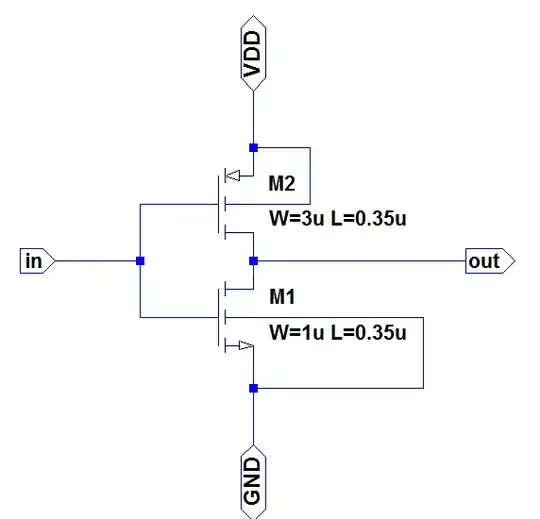

This is my inverter_035_1.asc:
Version 4
SHEET 1 880 680
WIRE 208 -96 208 -160
WIRE 272 -96 208 -96
WIRE 208 -80 208 -96
WIRE 160 -32 80 -32
WIRE 272 -32 272 -96
WIRE 272 -32 208 -32
WIRE 80 32 80 -32
WIRE 80 32 -16 32
WIRE 208 32 208 16
WIRE 448 32 208 32
WIRE 208 48 208 32
WIRE 80 96 80 32
WIRE 160 96 80 96
WIRE 400 96 208 96
WIRE 208 176 208 144
WIRE 400 176 400 96
WIRE 400 176 208 176
WIRE 208 240 208 176
FLAG 448 32 out
IOPIN 448 32 Out
FLAG 208 -160 VDD
IOPIN 208 -160 BiDir
FLAG 208 240 GND
IOPIN 208 240 BiDir
FLAG -16 32 in
IOPIN -16 32 In
SYMBOL nmos_035 160 48 R0
SYMATTR InstName M1
SYMATTR Prefix X
SYMATTR Value2 W=1u L=0.35u
SYMATTR SpiceLine ""
SYMBOL pmos_035 160 -80 R0
SYMATTR InstName M2
SYMATTR Value2 W=3u L=0.35u
SYMATTR Prefix X

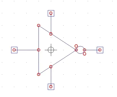

And this is my inverter_035_1.asy:
Version 4
SymbolType BLOCK
LINE Normal -16 32 -16 -32
LINE Normal 33 0 -16 32
LINE Normal -16 -32 33 0
LINE Normal 64 0 44 0
LINE Normal 0 -48 0 -21
LINE Normal 0 48 0 22
LINE Normal -16 0 -48 0
CIRCLE Normal 44 5 33 -5
PIN -48 0 NONE 8
PINATTR PinName in
PINATTR SpiceOrder 1
PIN 64 0 NONE 8
PINATTR PinName out
PINATTR SpiceOrder 2
PIN 0 -48 NONE 8
PINATTR PinName VDD
PINATTR SpiceOrder 3
PIN 0 48 NONE 8
PINATTR PinName GND
PINATTR SpiceOrder 4

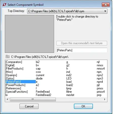

First, make yourself a user directory under 'sym':
New directory
Before adding anything (I already did, but we will get to that).
Start LTSpice, start a new schematic and then select add component:
I get this view with my parts directory shown:
My directory now viewable in LTSpice

Alright, I found a workaround by myself that works!
1) Design your circuit in LTSpice and name all nets that will be connect to outside world. Save the circuit in .asc format in a subfolder under E:\Program Files (x86)\LTC\LTspiceIV\lib\sym. Like this:
Simple inverter
2) Before leaving the schematic editor go to View - SPICE Netlist. Copy and paste the netlist into a lib file, let's say 'mysubcir.lib'. Add a line above the pasted netlist to define a subcircuit like this:

3) Go to File - New Symbol and design your symbol. Put the pins with same net names in your schematic, in this case we have four pins: "in out VGD GND". And then save the .asy file in the same folder that you saved .asc file. Like this:
inverter symbol
Now your new subcircuit is available globally. You only need to add ".lib mysubcir.lib" to your top schematic.
