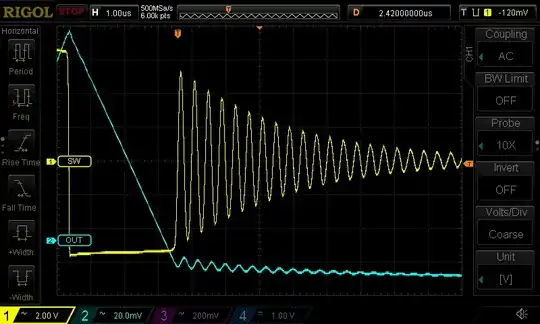

The LM2576 enters discontinuous conduction mode (DCM) at light loads (<500mA or so), and when it does, it exhibits vigorous ringing on the switch node when the diode turns off, the residual energy in the inductor bouncing back-and-forth between the inductor and the diode capacitance:
The datasheet states this is nothing to worry about, but that it can be addressed with an RC snubber across the inductor if desired. I understand most folks wouldn't bother with it, but since this is a learning project and my first chance to design a real-life snubber, I want to do the best I can and learn as much as possible for future snubbing challenges.
Also, the ringing counts as EMI in my world, and it does couple to the output:

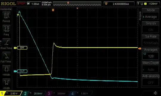

Here's before the snubber, switch-node in yellow, output in blue:
And here it is after:
The values I used were 1nF and 470R for anyone just looking for a recipe to try :)
