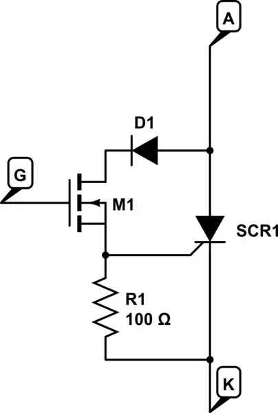

sensitve gate SCR is probably the closest you'll get. or you could put a mosfet on an SCR – Jasen Слава Україні Jul 15 '16 at 01:38

Jasen Слава Україні

I like that Jasen. Not a single component, but seems like what the OP is wanting. +1 – Marla Jul 15 '16 at 01:49
3I agree with Marla, however note that if you 'tease' the gate you can get a lot of power dissipation in some situations - eg. 400VDC and 100mA SCR trigger current, you could see 40W dissipation in M1 before the SCR turns on. – Spehro Pefhany Jul 15 '16 at 13:59
