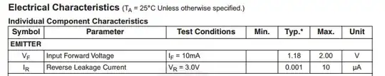

I need to use optocoupler to turn on a pnp transistor which will be able to conduct relatively high current, theoretically speaking 400mA (probably a few time higher).
Supply voltage for higher voltage side will be 12V and 3.3V for LED side of the optocoupler. If I look at the datasheet of optocoupler I see:
and
First puzzle I need to solve is next:
Does this mean that at 10mA (If) current 150mA will be able to flow through CE if the supply is capable of outputing that current?
If so is CE voltage drop negligible?
Update: Ok so now I know that I should give more attention to the graphs, but how to get appropriate IF value for desired Ic current is still a mystery to me.
  • No. It means that 150mA is the absolute maximum collector current for the optoisolator - notice "Absolute Maximum Ratings" in really big, really dark letters at the top of your image. For safe operation you will need to derate well below this threshold. You need to look at the current transfer ratio (CTR) for your opto to see how much collector current to expect at 10mA forward current on the diode. – Adam Lawrence Jul 14 '16 at 14:27

How much current flows in the output depends on the current transfer ratio
For the MOC8021, this is 1000% minimum (at the stated conditions):
The datasheet shows this:
MOC8020 and 8021 CTR
What this means is that at DC, 1mA in the emitter will generate a collector current in the output of 10mA at the stated conditions (If = 10mA, Vce = 5V).
The CTR varies with varying forward current as shown in this normalised graph:
Normalised CTR vs. If
To get the actual CTR, multiply the CTR by the nominal CTR from the tables.
If you are then going to drive a PNP, you need to choose a device where the DC current gain is large enough to keep the required collector current below the 150mA maximum rating.
