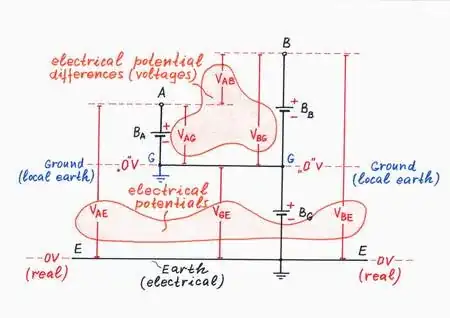

Here are two funny pictures illustrating a gravitational ground...
Gravitational ground
... and an electrical ground.
Electrical ground
