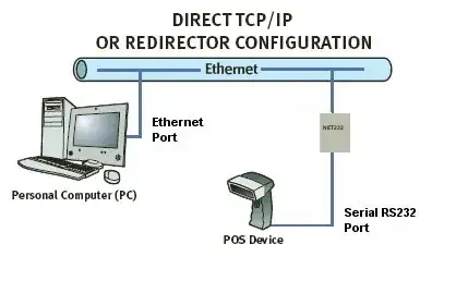

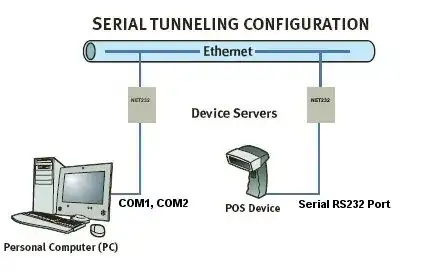

On the other hand, many manufacturers sell serial-to-ethernet converters which can be used in pairs to transparently connect serial devices using Ethernet infrastructure. Search for "Ethernet Serial"
Example from gridconnect.com
Sometimes these come with "ComPort Redirector Software" that create a Virtual Com port on a computer. These probably work with most applications that expect a real serial port. They may not work if you are doing low-level bit twiddling.
