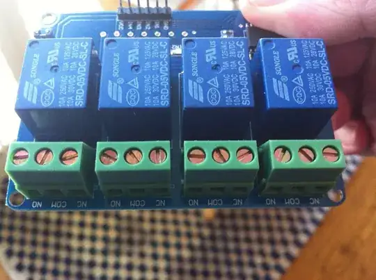

This will be my first attempt to control a 110v device (high voltage, by my standards!). Initial tests will be on a table lamp; eventual target may be a small 500W heater.
  • How should I wire the 110V device to the screw terminals?
  • Other than putting the unit in a plastic project box, what safety precautions should I take?
  • If the project box has a metal lid, should I attach the 110V ground wire to the lid?
  • what are the abbreviations NC, COM, NO?
This is the device I will be using:

    Don't forget to check the datasheet of the relays to see where the line and neutral should be connected (and if that matters for this relay). More on that [here](http://electronics.stackexchange.com/q/16646/1240) – AndrejaKo Jan 05 '12 at 00:45
  • Thanks, good note! I checked for this particular relay and there's no mention. Based strictly on the aesthetics I'll connect neutral together directly and run the hot line through the relay. :-) – Mark Harrison Jan 05 '12 at 02:13

Screw terminals like you show are a very bad idea for dangerous voltages unless the whole assembly is normally covered with something not easily removed, like a electrical box. The screws at the top of the screw terminals will be connected to their line. It would be too easy to accidentally brush up against them.
Your ultimate 500W load will draw nearly 5A, so make sure all paths of that circuit can handle that. I see the relays are rated for it, but what about the PCB traces between the relays and the screw terminals? If you are buying this board as a unit, check its ratings. Don't assume the whole board is rated for 10A just because the relays are.

As others have said, this should not be sitting on your table or on the carpet. Exposed 110V metal carrying 110V is dangerous, and the pins on the back side of the PCB, the exposed screws, and any stripped wires could also cause shorts or electrocution. On the note of

As Brian already, said, the abbreviations stand for:
  • COM: the common terminal. Connect your power input to this terminal.
  • NC: Normally Closed, the spring inside the relay pulls the contact to this terminal in the absence of a magnetic field. Unless you have something that should be powered if your unit is in a failure mode, or need to alternate between two devices with each relay, connect this to nothing.
  • NO: Normally Open, connect this to your switched device. It will connect to COM when the relay is activated.

  • In terms of safety, should you connect the hot or neutral wire to the COM terminal, or does it matter? – MBraedley Jan 10 '12 at 20:40
    Hmmm...I don't have my books available to check, but I think you should connect the hot wire to the relay. In theory, this will allow the entire system (which would otherwise be at mains voltage) to return to ground. This is how an ordinary lightswitch is connected (to the 'hot' wire), it seems sensible to do the same with a relay. – Kevin Vermeer Jan 10 '12 at 21:03

Olin's concerns are more than well-founded, the screws are recessed slightly into the blocks, so the danger is somewhat reduced. 110v can give you a nasty surprise when you're not paying attention.
Brian's response is correct for the Normally-open, Normally-closed and common abbreviations.
I have an assumption about the chip that's under your thumb in the photo - that's a relay control device? If it's not, there are other parts that you'll need to handle voltage spikes when you engage and release the relays electronically.

COM is the common terminal. It is connected to NC (Normally Closed) when the relay isn't activated and NO (Normally Open) when activated.

To hook up your load, just connect one wire of the load straight to one of your mains wires. Connect the other load wire to either COM or one of the NO or NC, and connect your second mains wire to COM if you connected the load wire to NO or NC, or vice versa.
For electrical safety, I agree with Olin, make sure you cover the assembly up before you plug in the mains. Also make sure you don't have any stray copper strands poking out from the wires when you stick them in the screw terminals...
You can attach the ground wire to a metal lid using a lug and a screw.
