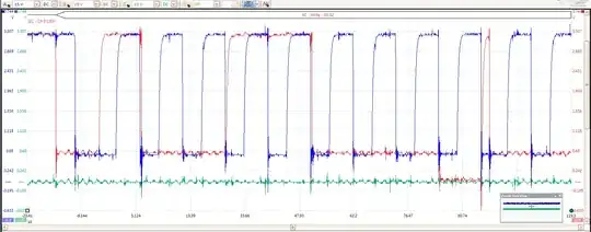

My scope probes are on 10X and have been trimmed. In the scope capture, Blue is clock, Red is data and Green is ground reference. The attached scope trace is taken on the device side (SX & SY). The trace shows the clock low to be ~0.6V above zero (green ground reference). Is this normal? Also it looks like the slave acknowledge (red) actually does pull the line to zero. The diodes are on the transmission side, so it shouldn't cause the 0.6V shift, should it?
Scope trace
The circuit work. The two I2C slave devices respond. However my questions are:
  1. There seems to be excessive ringing as compared to some other I2C traces I've seen. What can be done to reduce this?
  2. Do the bus side diodes need to be on both ends of the transmission bus or only on the slave side?
  3. Do the device side pull-ups need to be both the same value? Would having different values cause the offset shown?
Any additional comments or tips are appreciated.

The Output low voltage on the output side is typical 0.6Volt in the configuration that you use. So that is normal. Where the slave pulls the clock low you see almost 0Volt this is normal behavior. The pull-up resistors are not causing this offset.
According to the data sheet the clamping diodes need to be placed on both sides to reduce the transients a close s possible to the chip inputs.
The ringing that you see can be affected by a lot of things. Compared to a similar setup in the fat adhere you're pull-up resistors are quite high. Also the capacitors on the lines are not displayed in you're drawing. Also the capacitance of your probes can affect the ringing. The datasheet is very complete about acceptable ringing on the lines.

  • "the capacitors on the lines are not displayed in you're drawing" The PC9600 data sheet only seems to indicate capacitors on the device side when using a ribbon or flat telephone cable, as shown in Fig. 14 and Table 7. Since I am using an HDMI cable with twisted, shielded pairs, I did not add any capacitors between the SX and ground. Also, it is not clear from Fig. 14 and Table 7 if capacitors C2 are simply representing the typical bus capacitance or if they are capacitors added to the circuit. Should I add them? Would this help reduce the ringing on the device side? – JoeChiphead Jul 13 '16 at 15:28
  • "The datasheet is very complete about acceptable ringing on the lines." It appears to me that the data sheet is very clear about LINE side ringing. It does not seam so clear on the acceptable DEVICE side ringing, which is where my posted scope traces are taken. I even looked at datasheet NXP UM10204 "I2c0bus Specification and User Manual" and it contains very little information in regards to acceptable ringing. – JoeChiphead Jul 13 '16 at 15:30
  • I changed the 4.7k resistor to a ~1K ohm. It had no effect on the ringing. The only effect was to change the clock to more of a trapezoidal wave. i.e. the charge curve became almost straight. – JoeChiphead Jul 13 '16 at 20:35
