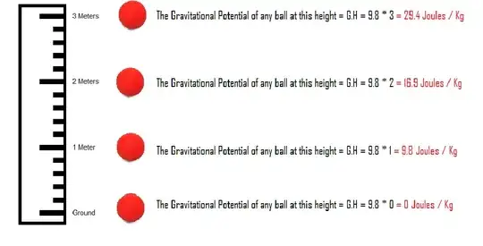

Imagine we have a ball of mass M = 10 kg.
This ball exists in a conservative gravitational field (the Earth's gravitational field). If we want to raise it by a height of 1 meter, we must - somehow - supply an X amount of energy, that gives the ball enough speed to move 1m above the Earth's surface.
We will give the ball this amount of energy in terms of kinetic energy (speed). So we throw the ball upwards with some speed, and as the ball moves upward, its speed decreases; and its potential energy increases until it stops and all the kinetic energy is converted to potential energy.
The following picture shows the amount of potential energy for a ball of mass M = 10 kg at different heights above sea level:
energy at different height levels
But what if we want to make a generic scale?
For any ball of an arbitrary mass, at any height, we can get the amount of energy for every 1 kg in it (Energy per mass):
energy per mass at different height levels
Now we can say that, at a height of 3 meters above sea level, any object of mass X will have an amount of energy equals 29.4 joules for every 1 kg of mass. This is due to the earth's gravitational field.
Voltage, or electric potential, is the amount of potential energy (joules) that any "charged body" within an electric field will have, for every 1 coulomb of electric charge in it.

  • One might add that the potential energy *does* directly translate into kinetic energy if there is only negligible "friction", for example in an (evacuated) cathode ray tube. The kinetic energy of an electron is indeed measured in "electron volts", eV, the energy an electron gains or loses when moving through a potential difference of 1 Volt. – Peter - Reinstate Monica Jul 14 '16 at 11:24

  • @MeTitus Yes. Energy is charge times voltage. One electron accelerated through 100 V will gain 100 eV of energy. Or 10 electrons accelerated through 10 V will in total gain 100 eV of energy. In a resistor all of this energy the electrons gain will be lost to the resistor in the form of heat. – Matt Feb 04 '21 at 02:19
    But the ball's speed increases if it is dropped from 3 meters, so does voltage affect the speed of electrons? – Qwerty Feb 27 '21 at 18:11
