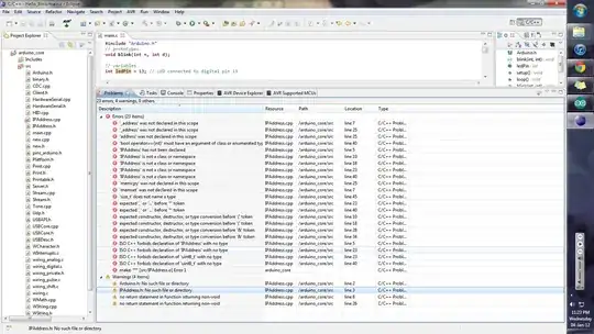

EDIT: Finally compiled a blinky project without errors. But there is still error on the CoreLibrary project. Here is the screen shot:

  • ArduinoCore library can be successfully compiled. But another blinky project cannot. Its showing error for all the arduino library functions. I have added the dependency on ArduinoCore project in the blinky project's preference. – 0xakhil Jan 04 '12 at 16:28
  • @oxakhil also please re-read my bullets as I edited them. – vicatcu Jan 04 '12 at 16:29
  • @oxakhil you might need to #include in your setup/loop source file as well (see edit2) with that I was able to build a Blink project that depended on the ArduinoCore static library project. Maybe I'll blog about this later... – vicatcu Jan 04 '12 at 17:04
  • When I try to build now, I get compile error on IPAddress.h.. '_address' was not declared in this scope IPAddress.cpp /arduino_core/src line 7 C/C++ Problem – 0xakhil Jan 04 '12 at 17:43
  • @oxakhil, what libraries are you using? can you post your sketch source code somewhere (e.g. pastebin.com) – vicatcu Jan 04 '12 at 18:06
  • I copied the libraries from the Arduino 1.0. Here is the sketch: http://pastebin.com/Rew47LrN – 0xakhil Jan 04 '12 at 19:27
  • Finally, after all the tweaking there is just one warning left: – 0xakhil Jan 04 '12 at 19:47
  • '[C@a81fd' has virtual method 'printTo' but non-virtual destructor Printable.h – 0xakhil Jan 04 '12 at 19:48
  • Is that warning totally okey??? – 0xakhil Jan 04 '12 at 19:49
  • @oxakhil What happens if you don't include the libraries in your project at all? (I haven't included them in mine). You also shouldn't need to define main - that's built into the core library. Just implement setup and loop as you would in the Arduino IDE. – vicatcu Jan 04 '12 at 19:55
  • @oxakhil, I get no warnings or errors, and that's the way I like it... :-) – vicatcu Jan 04 '12 at 20:16
  • Now it started giving me compile errors for all the serial library functions in the blinky project. >_ – 0xakhil Jan 04 '12 at 20:44

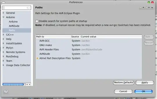

On Linux, before I could get Eclipse to work properly, I had to go through the preferences and change all the Arduino paths from "custom" to "system":
Check your paths - especially for the "AVR Header Files" entry.
Majenko
  • 55,955
  • 105
  • 187
  • Its already 'system' in the preferences for me. – 0xakhil Jan 04 '12 at 15:00
