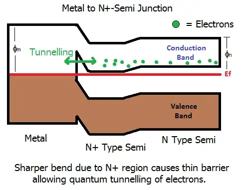

Ohmic contact using Tunnelling
Tunnelling in N+ Metal Junction
The more common method is to use the Schottky format (which forms a barrier), but to make the barrier larger - sounds odd, but its true. When you make the barrier larger, it gets thinner. When the barrier is thin enough, quantum effects take over. The electrons can basically tunnel through the barrier and junction loses its diode behaviour. As a result, we now form an Ohmic contact.
Once electrons are able to tunnel in large numbers, the barrier basically becomes nothing more than a resistive path. Electrons can tunnel both ways through the barrier, i.e., from metal to semi, or from semi to metal.
The barrier is made higher by more heavily doping the semiconductor in the region around the contact which forces the bend in the bands to be larger because the difference in Fermi level between the metal and semiconductor gets larger. This in turn results in a narrowing of the barrier.

  • @HenningMakholm not really, no. That would be inversion (like what happens in MOSFET channels when on). The key thing is scale, and its hard to draw, but essentially the idea is to make the barrier so sharp that at the top (close to the top of the valence band) it remains very thin. Because it is thin, electrons simply flow right through as if it were metal. – Tom Carpenter Jul 09 '16 at 22:04

  • @HenningMakholm see the update. I've now indicated the carriers that result from the dopants. The p-type dopant results in "holes" in the valence band. When you tip the structure (with an electric field), the holes float upwards. So if you apply a DC voltage to the diode, the metal moves up, and the p-type down. This causes the holes to flow upwards to the barrier. Electrons from the metal can then tunnel through the barrier to fill these holes (its as if the holes tunnel through from the semiconductor into the metal). – Tom Carpenter Jul 09 '16 at 22:14
