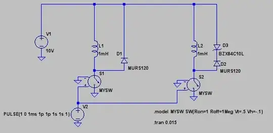

Here is an LTspice simulation of the situation
  • without a Zener diode (left sub-circuit) and
  • with a 10 V Zener diode (right sub-circuit)
Enter image description here
The top graph shows the power dissipation in both inductors. The area under both power curves must be the same (= energy stored in the inductor).
The bottom graph shows the switching signal (red) and the voltages at the bottom terminals of the inductors.
