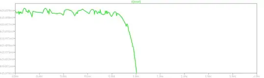

In the hope that adding noise to simulation moves us closer to the "genuine metastability" simulation pictures, I add a behavioral voltage source of pseudorandom white noise to the circuit. This noise source does hardly ever simulate the real MOSFET noises, but the .tran plot is similar to those presented in EE course slides on metastability.
meta-noise
A zoomed-in region of the graph
meta-noise-zoomed
