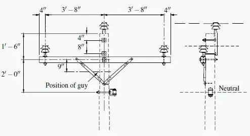

Wingspan, most likely.
Figure 1. The condor, monotypic genus, is the largest bird in the Western Hemisphere with a wingspan of up to 3.5 m.. Photo by Colegota on Wiki Commons.
Figure 2. Typical cross-arm support for < 10 kV three-phase system. Source.
Electrocution will occur if the bird's wings bridge the cables or a cable to earthed structure. Smaller birds will pass through unscathed.
