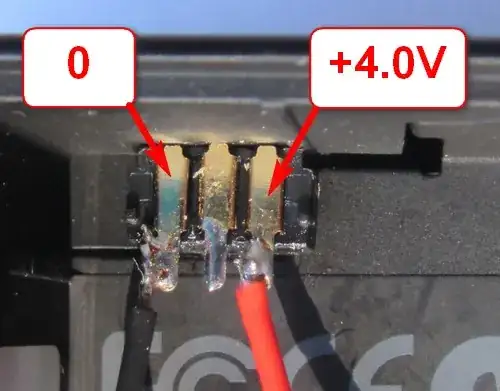

  • @transistor added picture. Exactly what the Switronix Battery Eliminator does for the Hero 3 model. Can I build my own? I am willing to solder directly onto the leads, as the camera is old and serves only this one purpose. It doesn't have to be pretty; it just has to work. Fixing the integrated USB connectors is not a long term solution for the type of environment in which the camera will be deployed (because the connector sticks out). The integrated USB connector on this particular unit has already failed once and was serviced, and now has failed again. – SkyNT Jul 08 '16 at 15:11

According to Benlo.com:
Figure 1. Hero 2 battery eliminator connection points.
Figure 2. Hardwired Hero 3 battery eliminator.
Using a Battery Eliminator with the Hero 3 Camera
GoPro cameras can be run off a 4 volt power source which replaces the internal battery. The voltage must be no less than 3.75V and no greater than 4.2V. The power supply must be capable of supplying 0 to 1.1 A of current without deviating from the above range. The T-sense pin on the camera is not needed with a battery eliminator power supply.
You can't supply directly from USB 5 V supply. Some form of regulation will be required.
