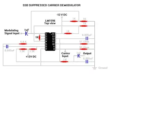

And another balanced modulator
And another

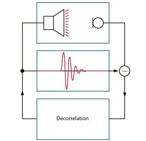

enter image description here . ______________________________________________

  • Model the room response with a multi-tap filter and optimise for lack of correlation with input signal. Probably well inside the abilities of higher end DSPs and probably lower

My method 1 above is fig 5 here
HTML version here
THEY SAY:
  • A sound reinforcement application is shown in figure 5. Here there is no far-end speech to feed the model. The local speech is immediately sent out the loudspeaker and is the only training signal available. The fact that the training signal is correlated with the local speech (seen as noise to the training process) provides a significant problem for the adaptive filter based modeling. This is particularly true if it is trying to maintain a model that is accurate over a broad frequency range.
    To overcome this problem some form of decorrelation is introduced (such as a frequency shift). This helps the broad band modeling process but adds distortion to the signal. As with the teleconferencing application if the model is not accurate further distortion occurs. The decorrelation, along with any added distortion due to an inaccurate model, makes this method less appealing for some venues. The big advantage to this type of a feedback suppressor is that your added gain before feedback margin is usually greater than 10 dB.

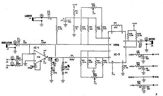

My method 2 is probably fig 27 here MC1494 used a a balanced modulator in Fig 27. Brain says they may use two and invert the signal to one input of one so you get only sum or difference out and not both. Note that text copied below says gain in gain is small. It would be interesting to know what happened if you pseudo randomly scattered the frequency shift.
