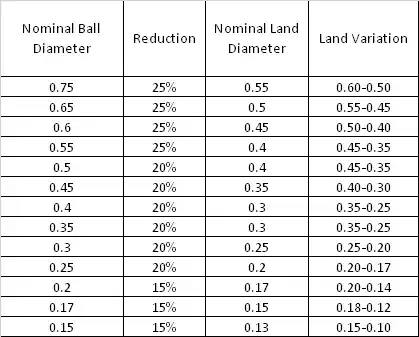

Look at IPC-7351A for NSMD Pads:
Look at the mechanical diagram for that package to determine the ball size. In your case a 0.35mm pitch BGA, the ball size is 0.15mm. Find 0.15mm on the left hand column and follow that to the column that says "Nominal Land Diameter" and see that the recommendation for the ball pad is 0.13mm. but the variation is about +/-0.25 which results in 0.15mm to 0.1mm. So it is OK.
