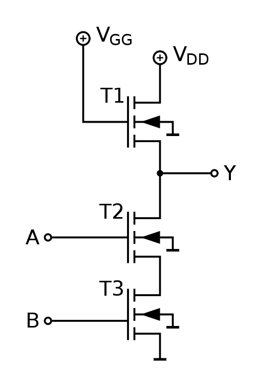

Here's an example of a "depletion-mode" NMOS NAND gate circuit I found on (German) Wikipedia:
NMOS NAND Gate - public domain image by Wikipedia user Biezl
The upper transistor is used in depletion mode to provide a load approximating a current source and balancing the rise and fall times. Due to the higher threshold voltages of early MOS technology, a 12 V supply may have been needed to provide a proper bias for the gate of the load resistor. The -5 V supply might have been used to bias the back-gates (or substrate nodes) of all the FETs in order to get them in the desired operating regime.
I'm making this a Wiki answer because some of what I've said is speculation rather than hard facts and I'm sure someone here can improve or correct me.

  • For what it's worth, the video chip of the Atari 2600 runs mostly off +5, but has one input which is driven with a pot connected to the 9V supply. That input drives the gates of enhancement mode pull-ups in a sequence of 30 inverters whose average propagation time should be roughly 10ns (pretty fast by the standards of the day, I would think; no other signal has to propagate through anywhere near that many gates during a clock cycle). – supercat Jan 04 '12 at 20:32
  • Another comment re the enhancement-mode pull-ups: the ideal practical pull-up device in NMOS logic would be a constant-current source whose current-carrying capacity did not fall off as the output voltage increased. Unfortunately, if a FET gate is at five volts, VGS will drop by half by the time the source has reached 2.5 volts. By contrast, if the gate is at 12 volts, the output can reach 4 volts while VGS is still 2/3 what it was when the output was at ground. – supercat Jan 04 '12 at 22:47
