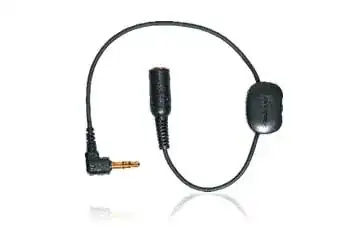

I know you said you wanted to make your own, but FYI RadioShack makes a Volume Control Cable for Stereo Headphones, and there are probably others out there as well. It would probably work best placed before your FIIO E3 amp.

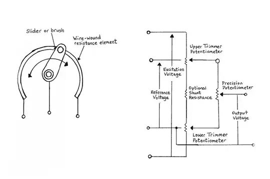

Keep in mind there are two ways of connecting the terminals of a wiper pot. Method #1 puts the resistance in line with the ground while the second method puts it in parallel, dumping the extra unused power back to the ground. This is called wiring it in a voltage-divider mode and is the correct method of doing things for an audio dial.
Refer to the following schematic to get briefly acquainted with the idea on how this works: potentiometer basic schematic
Moving the wiper as close to the ground as possible gives minimum resistance and thus maximum signal. While in case 1, having the ground at the end means you're adjusting the signal by just adding inline resistance, this is terrible and creates distortion by selectively modifying the output signal. As shown in this online calculator. It also requires huge potentiometers values to bring the signal's volume down below audible ranges.
Method 2#: Connecting it in voltage-divider mode solves all of these problems and can work just as well with a lower value pot, meaning minimal added distortion to the signal path, with most of the driving potential going towards moving the diaphragm membrane on your headphones/speakers.
