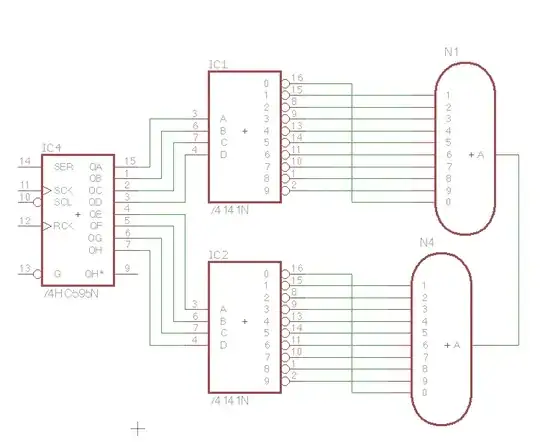

Enough rambling and back story - How should I design this circuit (I'm using Eagle)? I currently have this layout: enter image description here
My questions are probably a little idiotic:
  1. Where does my powersupply above come into this? (Do I drive the IC1 and IC2 with it?)
  2. Have I made any big blunders?

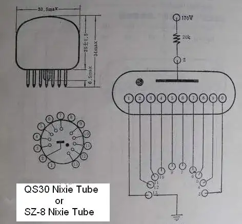

A Nixie tube is a version of a standard cold cathode vacuum tube / valve / ... .
The Anode is most positive and the Cathode or Cathodes most negative.
The diagram below from here shows a typical Nixie which is representative enough of your one for the purpose. The Anode connection (A) is taken to high voltage +Ve via a resistor or current source. The Cathodes are grounded via the driver IC when illumination of the selected element or elements is wanted

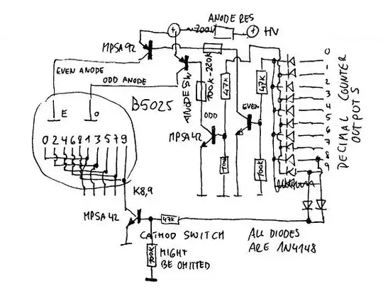

Excellent DIY page - At a skim he seems to be over voltaging his driver ICs - I'd need to look to see if I've missed something.
Ah - clever. IF another Cathode is on, an off-Cathode will rise to the struck voltage of the other Cathode. If all are off it may be "interesting". Even a "." would do.

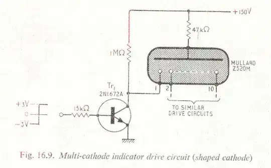

If you want to use a "standard IC" with maximum voltage of 5 V or 15V or similar then you need some sort of high voltage buffer or driver. The most basic method is to use a "common emitter" transistor buffer - the IC drives the base via a resistor and the high voltage to be switched to ground is connected to the collector as shown below. Use MPSA42 transistor or equivalent (probably).
The above circuit turns the Nixie on when the base drive is high and off when Vin = low. If a driver IC is used low = on and high or float = off then the sense is inverted by this circuit.

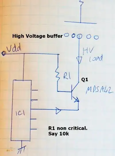

The circuit below also provides high voltage buffering but with no inversion. Vin = low = on , Vin = high = off.
The disadvantage (or a feature :-) ) is that Q1 provides voltage buffering but not current buffering - the IC must provide whatever drive current is required by the load.
This is a "common base circuit". This arrangement in this sort of context is extremely useful but rare - I searched google images and could not find a single example that I could adapt.

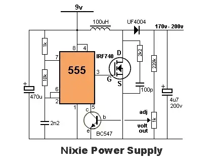

Nixie power supply.
Nothing overly special about circuit.
THIS CIRCUIT WILL HAPPILY KILL YOU IF YOU LET IT !!! From here

  • Lots of good information, and I especially like the 555 circuit. You say that Nixie tubes are thermionic valves, but there is no "therm" or heated element like a vacuum tube, and [Wikipedia](https://en.wikipedia.org/wiki/Nixie_tube) says its a cold cathode: "It is therefore called a cold-cathode tube (a form of gas-filled tube), and is a variant of the neon lamp" which seems right to me, and in addition, if it's a thermally heated vacuum tube, I doubt that Wozniak could have made any kind of useful wrist watch out of it. ;-) – MicroservicesOnDDD Nov 27 '20 at 19:59
  • @MicroservicesOnDDD Thanks / grumble :-) - almost 9 years ago! I removed the reference to 'thermionic', but my brain wants to argue that its a useful term even though it's technically wrong :-). I got to tidy up a number of 9 year old typos, so it was useful. – Russell McMahon Nov 28 '20 at 11:38
In Eagle, you need to press the 'activate another gate' button to connect power to your IC's (logic IC's typically have a logic and power symbol section).
What I think we should point out that nixie tubes work on very high voltages. I wouldn't be working on breadboards with 180V supplies. I'd rather make just a simple board for connecting the power supply and the tubes together, so that stuff doesn't go anywhere. Also note that 180V is very high voltage, and it's DC, so be careful.
What you should check whether your IC1 and IC2 are able to handle the voltages of nixie tubes. If they are 'on' you're probably going to make sink the output. I.e. , approx. 180V will be on the segment of the tube, it will light up and it looks cool (if all is well). If you want the segment to be off, the outputs of the 4141N's have to 'block' 180V. Because no current (initially) is flowing, the voltage across the tube (and with that I also mean the extra 20k resistor as shown in Russell's drawing) is zero and the voltage on the IC pins is 180V.
So I wonder if you have checked the IC you're whether it can do that. If I look up the datasheet at alldatasheet (which is not the most reliable place to get your datasheets from , by the way) it says a recommended off-state voltage of 60V. If you connect it to 180V it will go smoke. I don't know whether you have more specific datasheets of your russian version?
Hans
  • 7,238
  • I've added details of the Russian bin-dec IC I have - looks like I should be powering them with 5V but use a high voltage transistor between it's output and the nixie and high DC voltage. Any recommendations? – JP. Dec 31 '11 at 15:34
  • You can do one of three things: (1) `invoke` the power pins as you suggested, (2) name your power nets *GND* and *VCC* or whatever the gate author decided to name them and they'll be connected automatically (but not shown *anywhere* on the schematic - I can't stand this method) or (3) don't use gates that have multiple sections. – Kevin Vermeer Dec 31 '11 at 17:53
