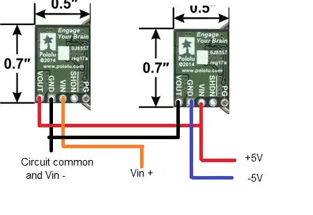

The short answer is not the way you have described: these are non-isolated converters.
As you can see in the picture (from the web site), there is a single ground pin (for both input and output).
Converter power pins
To achieve what you want to do you can either use isolated converters or you can use two of them in this manner: use one to get 5V; power the second one from this 5V to get a negative output provided your total load is within the current allowed from the first regulator.
Negative regulator from buck
As these are rated for 36V you should be fine - the second regulator will see an effective 10V in to out.
I made a picture of two regulators showing how I would hook them up for +5V and -5V:
Using two bucks for dual polarity supplly
Hopefully that is clear.

  • Awesome! Thanks. So the first dc-dc GND should not be connected to a common ground that all other components will share, right? It effectively floats with no connection? The second dc-dc's vout node becomes the ground for all components? – nick_name Jul 01 '16 at 13:19
    The first converter ground *is* connected to the common ground and the second supply uses *its positive output* as ground. – Peter Smith Jul 01 '16 at 13:22
