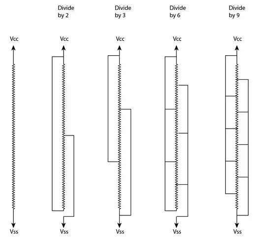

If you have an open coil resistor handy, but it's too high resistance and too low current capacity for your needs, you can tap it thusly:
You're dividing the resistor into n segments, which will make the whole suitable for the same wattage at 1/n voltage.
The gory details: If the pack is resistance r, then resistance of each segment will be, obviously, r/n. So with all of them in parallel, resistance is (r/n)/n. Sorry, can't find superscript in the app.
