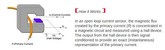

Figure 2. Principle of operation of a Hall effect current sensor. Note that the core gap would typically be very small - just enough to slide the chip in and is open wide here for illustrative purposes. Source: Tamura Current Sensor Products.
Figure 2 shows a Hall sensor installed in the gap of a magnetic core.
  • When the magnetic flux is vertical through the sensor as shown a reference or control current in the y-direction will produce a voltage at right-angles in the x-direction.
  • The voltage will be proportional to the product of the reference current, Ic, and the magnetic flux.
  • Since the magnetic flux in the core is proportional to the ampere-turns on the prmary conductor being measured we can amplify the Hall voltage to give a signal we can work with.
  • Some on-board electronics (not shown) carry out the amplification and add an offset so that the device can sense current in both directions while being powered from a single supply.
Tamura sensor provides only two current specs: Saturation current (looks like a primary current, in this case 100A or 300A) and also "consumption current" Icc which is probably "secondary" current producing the output Icc<=15mA.
  • Saturation current is the current at which the core is magnetically saturated. Any further increase in current will produce little or no increase in flux (or sensor output). Note that the saturation current is 1.25 times the rated current to give some headroom before saturation starts to take effect. (It's not a sharp limit.)
  • The 15 mA will be made up of two parts.
    • Some current to power the on-board electronics.
    • The control current, Ic. This will be the main current draw and will be a fixed value chosen as a trade-off between increased sensitivity and power consumption.
  • Power consumption will be given as \$ P = VI = 5 \times 15m = 75~mW \$ as you correctly calculated.
