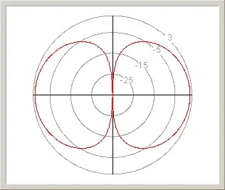

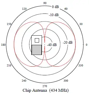

Such resonators have properties similar to classical dipole antennas. Radiation pattern of a typical chip antenna (on the right, source) is practically identical to the pattern of a dipole (on the left, source):
(both antennas are oriented vertically, and so are radiation pattern sections)

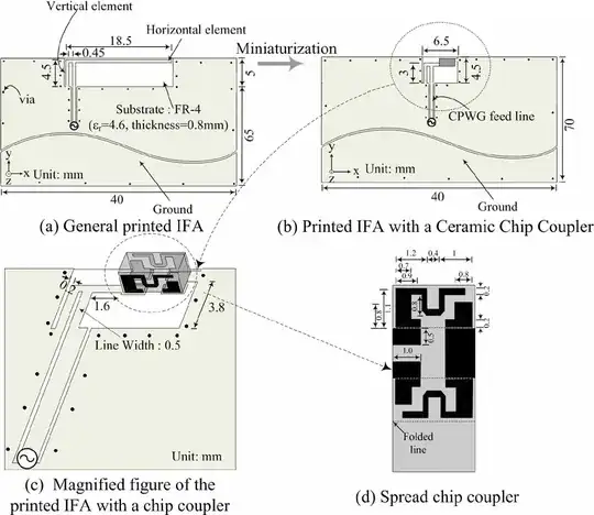

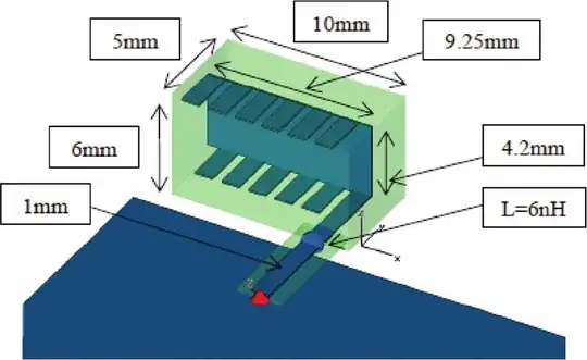

On the topic of the mysterious chips of material that are possibly more easily recognized as ceramic chip antennas, it is obviously unlikely that commercial designs will have the design of internal metallic structures published. To see inside these pieces of ceramic, someone needs to publish the design of the delicate metal films deposited inside the material before sintering. The place for that: research journals.
Starting with a familiar rectangular prism design for dual-band 900MHz and 2100MHz operation:
dual-arm conductor ceramic chip antenna from http://ieeexplore.ieee.org/ielx5/4913660/4957855/4958578/html/img/4958578-fig-1-large.gif
Another such design for UMTS (1920-2170MHz) operation that uses metalization inside a ceramic carrier:
single band ceramic chip antenna from http://ieeexplore.ieee.org/ielx5/6313473/6324891/6324915/html/img/6324915-fig-1-large.gif
