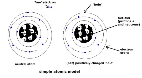

Electrons are present in every atom.
In materials such as metals (good conductors) the outermost electrons are very loosely bound to the nucleus and tend to wander around randomly in the material matrix leaving 'holes' in the normally neutral atom's electron structure.
These 'free' electrons take their energy from thermal energy. Any individual electron (negative charge) wandering by a positively charged 'hole' will be attracted and may fill the gap. It may then sit there for a while and move off. Its a very random/chaotic process.
The result is that the material stays electrically neutral even though billions of free electrons are randomly wandering about in all directions at any given time. There is no net drift in a particular direction.
