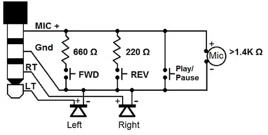

Each switch bridges the high-impedance microphone with a low resistance, allowing internal circuitry to sense the buttons. Here's a helpful image:
The MIC+ line has a bias voltage (to supply the mic), and by adding some additional circuitry to the mic preamp, it's easy to differentiate those resistor values.
This is the most common scheme for "on-headphone" controls. Additionally, it's very easy to implement in the headphones, allowing for cheap headphones and requires only a little bit more circuitry in the phone.

    Oh, and in that case the schematics might be slightly misguiding - at least as far as Android headsets go. The values are: 0 ohm for the "Play/Pause/Hook" "media button", 240 ohm Vol+, 470 ohm Vol-, 135 ohm optional "Voice Assist". All with 1% tolerance. Mic >1000ohm. – SF. Jun 26 '16 at 00:48
    Also, makes me wonder: if I plug a standard (non-phone) earphones, with no microphone or any controls - these would appear as the "Play" button constantly pressed? (the MIC connector touching the same GND area of the jack as GND). – SF. Jun 26 '16 at 00:54
    @SF the phone detects that and disables the MIC and button functions. And some phones, like the iPhone 3 (irrc) had issues so you had to get a TRRS to TRS adapters to prevent the short causing issues. – Passerby Jun 26 '16 at 01:38
    @SF. no, its much more tolerant in practice. Even android's page shows 70 ohm or less A, 110 - 180 ohm B, 210 - 290 ohm C, 360 - 680 ohm D. – Passerby Jun 26 '16 at 01:51

There are two basic types.
  1. Use a variable resistance between mic and Ground to signal different actions. The simplest being shorting mic to ground for Answer/Hangup/Take Picture. Ex: Android's Wired Audio Headset Specification v1.1:
  1. In or Out of band signaling. These use a microcontroller to insert a coded signal on the mic. Apple started this with one of their (now older) iPod Shuffle, and I believe thats what the current iPhones and MacBooks use.
