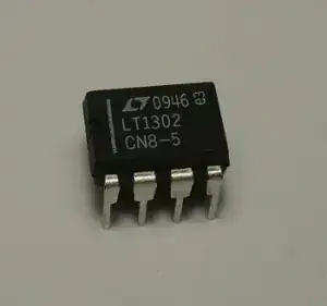

So after staring at a few ICs today, I was wondering what the "e3" or "e4" stands for on the top of an IC. For example, here is an e3:

It is regarding the lead content or plating finish. Here is an excerpt from IPC/JEDEC J-STD-609:
e0 - contains intentionally added lead (Pb)
e1 - SnAgCu (shall not be included in category e2)
e2 - Sn alloys with no Bi or Zn excluding SnAgCu
e3 - Sn
e4 - Preplated (e.g., Ag, Au, NiPd, NiPdAu)
e5 - SnZn, SnZnx (no Bi)
e6 - contains Bi
e7 - low temperature solder (\$\le\$ 150C) containing Indium (no Bi)
e8, e9 - unassigned
