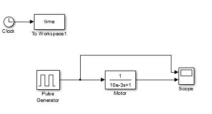

Theoretically, you would need to know the motor's time constant in order to choose the 'right' PWM frequency. As you probably know, the time it takes the motor to reach almost 100 % its final value is $$ t_{\text{final}}\approx 5\tau$$
Your PWM frequency has to be high enough so that the motor (essentially a low pass filter) averages out your input voltage, which is a square wave. Example, let's say you have a motor with a time constant \$\tau=10\text{ ms}\$. I am going to use a first order model to simulate its response to several PWM periods. This is the DC motor model: $$\frac{\omega(s)}{V(s)}=\frac{K}{10^{-3} s+1} $$
Let's let \$k=1\$ for simplicity.

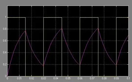

But more importantly here are the responses we're looking at. For this first example, PWM period is \$ 3\tau\$ and the duty cycle is 50 %. Here is the response from the motor:
The yellow graph is the PWM signal (50 % duty cycle and period \$ 3\tau=30 ms\$) and the purple one is the speed of the motor. As you can see, the speed of the motor swings widely because the frequency of the PWM is not high enough.

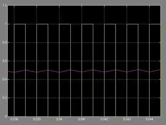

Now let's increase the PWM frequency. The PWM period is now \$ 0.1\tau=1\text{ ms}\$ and duty cycle is still 50 %.
As you can see, now the speed is pretty much constant because the high frequencies components of the PWM signal are being filtered out. In conclusion, I would pick a frequency that is at least $$f_s\geq \frac{5}{2\pi\tau}$$
