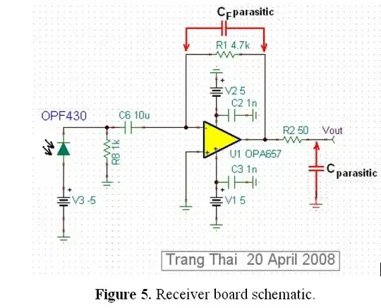

Full enough details to build one of a 160 Mbps at 1 metre free air LED to PIN diode link here
Free Space Optical Communication Link Using LEDs
ECE 4007 Senior Design Project Section L01, FSO Group Adam Swett Clayton Huff Trang Thai Nguyen Trinh
May 1, 2008
Receiver:

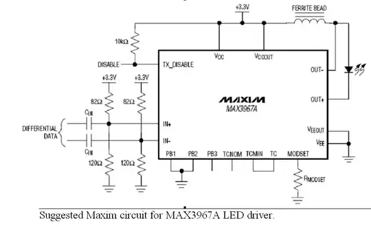

Transmit circuit BUT see text:

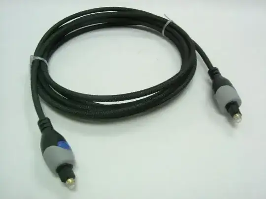

You can but optical connecting cables for domestic AV systems - highly available. You can even get them as standard XBox and PS3 accessories.
Connectors are generally known as "TOSLINK" - actually a JIS F05 connector.
Lots of info here {Wikipedia} including the rather poor bandwidth and range achieved.
They say:
  • TOSLINK cables can temporarily fail or be permanently damaged if tightly bent. Their high light-signal attenuation limits their effective range to about 6 metres (20 ft).
    Bandwidth can be 10 MHz with high-purity quartz fiber, but 5 to 6 MHz for a cheaper plastic cable.[5]
    A TOSLINK fiber optic audio cable being illuminated on one end Several types of fiber can be used for TOSLINK: inexpensive 1 mm plastic optical fiber, higher-quality multistrand plastic optical fibers, or quartz glass optical fibers, depending on the desired bandwidth and application.
    TOSLINK cables are usually limited to 5 meters in length, with a technical maximum1 of 10 meters, for reliable transmission without the use of a signal booster or a repeater. However, it is very common for interfaces on newer consumer electronics (satellite receivers and PCs with optical outputs) to easily run over 30 meters on even low-cost ($0.75/m) TOSLINK cables. TOSLINK transmitters operate at a nominal optical wavelength of 650 nm(~461.2 THz).
