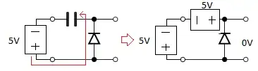

A way to more intuitively understand the circuit is to assume the capacitor to be a quick charging battery, and assuming a +/-5V voltage input for concrete numbers.
Starting on the negative half-cycle, up to 5V charges the capacitor through the diode. The capacitor effectively becomes a 5V battery. The potential difference in the output of the circuit at this point is 0V.
Then on the positive half cycle, up to 5V is behind the charged 5V capacitor, similar to having two batteries in series, making the potential difference in the output to be 10V.

    An excellent approach for intuitive presenting the circuit! To think of the capacitor as a "rechargeable battery" is my favorite approach when explaining capacitive circuits. – Circuit fantasist Apr 26 '20 at 06:56
