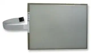

If you want it to be able to sense a touch anywhere on the screen you will need something like this:
At £22 this seems a bit overkill to me just to change a picture, but I'm not aware of anything else out there that would do.
