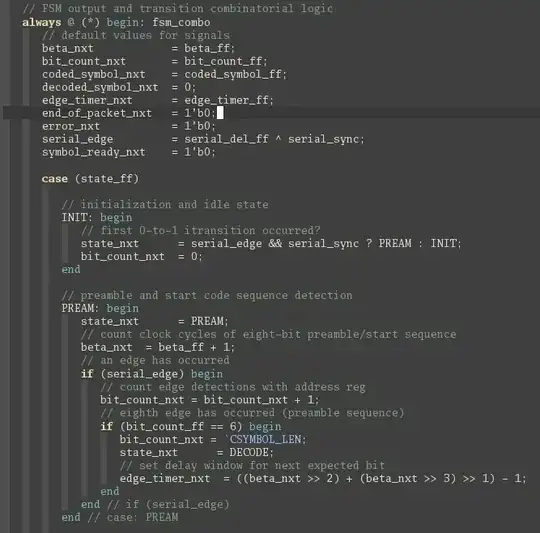

With regular IDEs, you are stuck with what they offer you. But with Emacs 24, you can customize it to whatever bizarre desire you have! I use it with prelude, and highlight-indentation modes. Look how purty!
Emacs is not exactly an IDE, but why not make it one?
- Version control
- Hotkeys to run your external compiler, lint tool, simulator, make file, etc.
- Can add code folding
- Hotkeys to insert common code blocks
- Automatic commenting
- You probably already have it!
