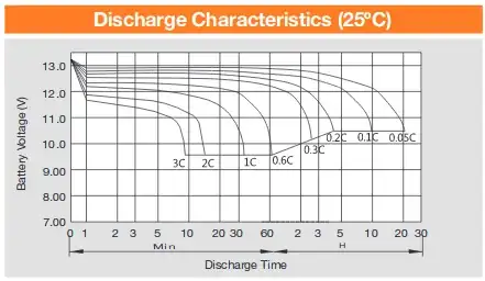

Rules of thumb given in other answers are often good enough but if you can find the datasheet of the battery it's best to check the relevant graph. As an example here's the datasheet of a low cost 12V battery. In the datasheet you'll find this graph:
Graph of voltage versus time for various currents
Let's say that this is a battery with 7Ahr capacity and that you want to draw 14A. You'll have to observe the 2C curve (2C means to discharge at 7Ahr*2/h=14A). You'll note that this battery will drop to 9.5V-10V after about 15mins. Of-course this is only true for a fresh from the shelf battery kept at 25 deg.Celsius. Temperature, age and usage negatively affect the performance.
