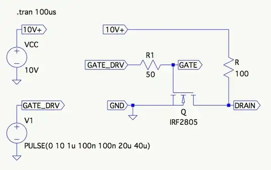

I've set up a very simple circuit like so:
Which produces this MOSFET turn-on waveform on simulation:
A knee appears in the drain voltage drop about 20% into the Miller plateau.
I built the circuit up:
And the scope confirms the simulation quite well:
I believe I understand the "pre-shoot" bump (\$C_{gd}\$ charging current running "backward" through the load resistor), but am mystified as to how to account for the knee in the drain voltage drop.
Can someone more experienced with MOSFETs help me understand?

  • Remove (short!) the 50R from the gate and try again. The MOSFET gate is not just a capacitor, it's a little more complicated. And in any case you have to open and close it quickly. –  Jun 18 '16 at 06:03
  • The resistor is just in the LTspice model to simulate the Thevenin resistance of the signal generator. I don't have it in the actual circuit. This provides a gate drive current of about 200mA, which is actually quite respectable and where I want it to be able to observe the turn-on characteristics clearly. I'm not looking to get rid of the bump so much as understand specifically what it represents :) – scanny Jun 18 '16 at 06:06
    Ok, than yes, it happens when you charge the capacitance between gate and drain. I that time the Ids is constant, nice feature for certain applications –  Jun 18 '16 at 06:08
  • By the way, it's almost a crime to use signal generator to switch a mosfet. You should use a gate driver between them. –  Jun 18 '16 at 06:09
  • please show gate_drv in spice plot. – placeholder Jun 18 '16 at 06:24
  • @placeholder - Done. – scanny Jun 18 '16 at 06:31
    Looks like Miller Effect from Cgd? If you add a 100pF cap from gate to drain, does that exacerbate it? – Krunal Desai Jun 18 '16 at 06:33

The slope of the drain voltage depends on the gate-drain capacitance Cgd. In case of the falling edge the transistor has to discharge Cgd. In addition to the load current for the resistor it also has to sink the current that flows through Cgd.
It is important to keep in mind that Cgd is not a simple capacitor but a nonlinear capacitance that depends on the operating point. In saturation there is no channel at the drain side of transistor and Cgd is due to the overlap capacitance between gate and drain. In the linear region the channel extends to the drain side and Cgd is bigger because now the large gate to channel capacitance is present between gate and drain.
As the transistor transitions between saturation and linear region the value of Cgd changes and therefore also the slope of the drain voltage.
Using LTspice Cgd can be inspected by using the "DC operating point" simulation. The results can be viewed by using "View/Spice Error Log".
For a Vgs of 3.92V Cgd is about 1.3npF because Vds is high.

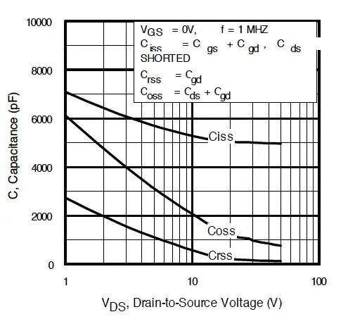

The variation of Cgd (labeled Crss) for different biasing can be seen in the plot below taken from the datasheet. enter image description here

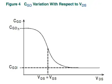

UPDATE: Mario got the right answer above, so leaving this one just for historical interest. This behavior looks to have everything to do with it being a VDMOS (as are many power MOSFETs I gather), which might explain why many of the general MOSFET resources (that tend to focus on monolithic MOSFETs) didn't mention this phenomenon.
Ok, just as I was about to give up on understanding this, the interwebs have granted me a morsel:
This is from IXYS Application Note AN-401, page 3.
There is no explanation of the device physics behind this, but I'm satisfied enough with this for now. This curve would well account for the inflection I'm seeing.
My attempts to explain it to myself with the dynamics of the channel inversion layer have ended in puzzlement. I see no clear inflection point in what I understand it to look like as when \$V_{GS}\$ = \$V_{DS}\$. (These are my best inferences, not something official I read somewhere.) Note that I used \$V_{GD}\$ here (\$V_{GS} - V_{DS}\$), somewhat unconventionally, knowing that \$V_{GD}=0\$ was what I was looking for :)
If anyone has a reference or knows the physics well enough to explain the curve above I'd be very grateful. I'll give the right answer cookie to anyone who can :)
