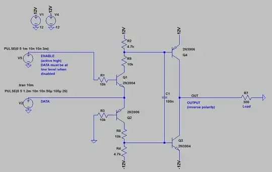

This answer tries to solve the problem as originally stated. Which I understood as, basically, a level shifter that takes 0/5V as input and +12/-12V as output, with an enable/disable option that would put the output in high-impedance state. When enabled, this shifter must be able to source/sink at least 35mA. The timings, however, are not that critical (max switching speed about 10kHz).
Output driver
Here is the circuit I ended with. It is using only discretes (good ol' BJTs), but not many of them. It take +12V and -12V as supplies, and the ENABLE and DATA signals as 5V digital logic. Signal is delayed by a few µS (there is a small difference between delay on low-to high and delay on high-to-low transitions). To simplify the circuit, when ENABLE is inactive, the DATA input must be at low level. Otherwise, output will still be driven. The last important fact is that input and output have opposite polarity (as all RS-232 drivers, as I remember).
LTSpice asc file: http://pastebin.com/6hESR81u
There are a few tricks in this circuit:
  • The way the first stage of transistors is wired: instead of applying the signal to the base, we apply it to the emitters. But the result is actually simple: when the signal is low (and ENABLE high), Q1 is on and Q2 is off, and when the signal is high, Q2 is on and Q1 is off. Then, if Q1 is on, Q4 is on, providing +12V. If Q2 is on, Q3 is on, providing -12V. As simple as that.
  • The C1 capacitor: this tricks eliminates the shoot-through on transitions. When the signal changes, there is a short time (due to the inaccuracies, delays involved, ...) during which both Q4 and Q3 conduct. This creates a short from +12V to -12V, and a rather high current can be wasted. C1 forces Q4 and Q3 to change state at the same time, reducing this effect to a minimum.
  • It is the ENABLE signal which is used as the voltage source to feed Q1 base. If both DATA and ENABLE are low, no transistor is turned on at all.
Note that this circuit must be properly decoupled. Put a 1µ ceramic cap close to Q3 and Q4 supplies.
This circuit can provide at least 50mA of current, given the min Hfe of the transistors suggested. The base of Q3/Q4 are biased with about 1mA. You could go above that by diminishing R2-R9-R8-R4, but the circuit would consume more and the current sourced/sinked from the DATA input would be greater (currently about +/-2mA).
You can make it much faster by putting small caps (in the 100pF range) across the base resistors. But this is not necessary here given the timings required.
