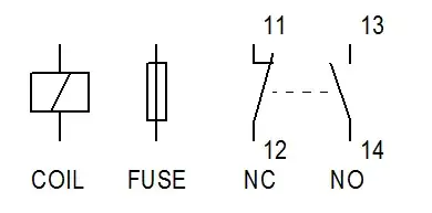

I found this relay inside an industrial x-ray machine. What does the rectangular box with a horizontal line through it, in the bottom left of the first picture, mean?

  • Which crossed rectangle? I see two rectangles in the first picture that have a line across them. The first is the relay coil (rating beside it says: 24-240VAC/DC) The other is a fuse ( rating beside it says 6AF/ 4AT.) – JRE Jun 10 '16 at 13:27
  • I'm sorry, its my bad... I am asking about the horizontally crossed rectangular box at the bottom left of the first picture. – soosai steven Jun 10 '16 at 15:38
As others have answered, the symbols are those of a relay and fuse.
Figure 1. European electrical control drawing symbols. The first contact will be numbered 1x, the second 2x, etc. Normally closed will be numbered n1 - n2 (where n is the contact) and normally open will be numbered n3 - n4.
The Pilz PNOZ X2.8P is one of a range of "E-STOP relays, safety gate monitors" used in industrial machine control cabinets. Internally there may be three relays arranged in a configuration similar to that of Figure 2.

It's a symbol for the relay coil. Similar to the ones that can be found for example here:

The symbol above represents the relay coil and the information next to it specifies the coil characteristics.

The symbol on the same line as "6 AF/4 AT" represents a fuse.

  • Are you saying there is a fuse inside this relay? – soosai steven Jun 10 '16 at 16:14
  • Yes, I'd expect to find a fuse in the relay - but you should study the datasheet for the relay to be sure. – Peter Bennett Jun 10 '16 at 17:50
  • [Here's the datasheet. Yes, it has a fuse.](http://www.goering-gmbh.de/uploads/not-aus_sicherheitsgeraete/PNOZ-X2.8P.pdf) It would appear to have a bit of "intelligence," so there's probably a fuse to protect the power supply for whatever is providing the "brains." – JRE Jun 10 '16 at 17:52
  • the 6 AF/4 AT is the fuse's current rating with german abbreviations: F = "flink" = fast acting, T = "träge" = slow-blow. It means you can replace it with either. – dlatikay Jun 10 '16 at 18:30
