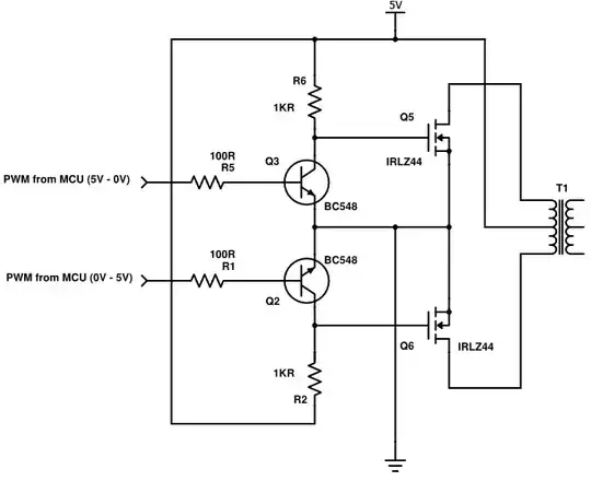

I thought the question didn't need an example circuit diagram, but here goes it:
I got to this circuit based on other questions I asked in here. I'm using 5V and the load is about 1A. As you can see, I'm driving a transformer. In this configuration, I have 10 Vpp on transformer primary, and secondary elevates this to 1500 Vpp.
Based on current comments and answer, it's already pretty clear to me that using a driver is the easiest, cheapest and simplest way to achieve lower swirching losses. But if there's a way to improve the circuit without a driver, I would be interested on learning about it.

  • @JohnBirckhead, I have updated the question with more info and a circuit diagram: I'm using 5V with 1A load, and I'm using a half-bridge. – Marcovecchio Jun 10 '16 at 16:18
  • @WarrenHill, I have updated the question with more info and a circuit diagram, thanks! – Marcovecchio Jun 10 '16 at 16:19
  • @MarkoBuršič, I'm using the mosfets to drive a transformer, please see the updates I made to the question. – Marcovecchio Jun 10 '16 at 16:20

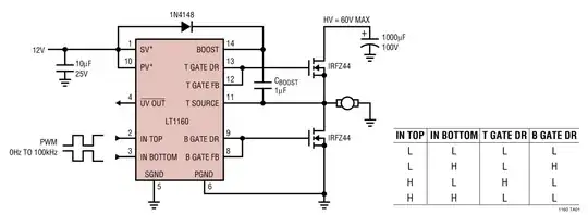

Either choose a better MOSFET or use a push-pull driver like this: -
Notice that this chip uses identical MOSFETs in the output stage. Here's another using the FAN7842 from Fairchild: -
You should also make sure there is enough deadtime between one turning off and the other turning on.
Both devices can be used to drive single MOSFET outputs if needed. Here's one that drives a highside MOSFET: -
Avoiding P channel devices will earn you a couple of percent more efficiency (genralism alert). This is a useful set of images to give other ideas.
  • Thanks a lot for the answer and examples, Andy. The most common driver I can find in my area is the IR4427. It appears to be good for the job, do you recommend it? Does it have any pros / cons when compared to your suggestions? – Marcovecchio Jun 10 '16 at 16:22
  • Yeah that looks OK. I've never used it but it seems to have the right credentials. If you are using a push pull mosfet arrangement it will only drive low side MOSFETs but, if that's all you are using then no problems. – Andy aka Jun 10 '16 at 16:46

Good gate drive is a step in the right direction and has been stated in other answers. Now it is time to look at T1 .There will be some leakage inductance between each leg of the CT primary.When you turn off Q5 or Q6 the current is broken .Energy stored in leakage inductance will go into horrible high voltage spikes in your circuit .You must deal with this to stop Mosfet failure .When you plug in ballpark figures for this inductive energy that on your circuit is wasting and multiply by frequency to estimate power loss you will find that these losses are bad .So try to recover the wasted power to limit the voltage spikes and keep the mosfets cool.One straightfoward way to recover this energy is to build your passive snubber that burns power into a resistor so the fets do not blow anymore.Then optimise the waveforms .Now decide if you want to put the energy into the input or the output or some aux device like say what I did was the cooling fans .Now all you need to do is build a small DC/DC convertor to do this .You should be able to get 90% back without too much effort.You could also try an active clamp system .Active clamps are easy to drive .I have not implemented an active clamp.
Autistic
  • 14,235
  • 65
