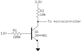

Your circuit is fine and would isolate if the ground weren't tied together. It would be appropriate if you had a separate floating 12 V source that you wanted to test the presence of.
However, since both sides have a common ground, the 12 V and 3.3 V supplies are not isolated from each other. Since they are not isolated, you can use a more direct connection. Your opto-isolator would still work, but adds unnecessary cost and complication.
One simple approach is:
This inverts from the logic you have. The microcontroller input will be low when 12 V is present and high otherwise. Since it's a microcontroller input, you generally do what's convenient for the hardware and handle the polarity in the firmware accordingly.
