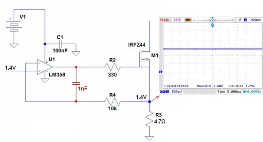

R2 (10k R4 in my diagram) is there to form together with C1 (1nF capacitor) a Miller Integrator to prevent unwanted oscillation. And yes, this circuit will sometimes oscillate, mainly due to poor PCB/breadboard design. And here you have a real world example (the breadboard one).
Without the Miller capacitance: circuit diagram and trace showing oscillation
And after I add the Miller capacitance into the circuit: Circuit diagram and trace, this time showing flat output

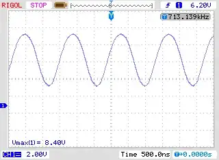

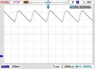

Today I test this circuit again. And the result are: For RG = 0 Ohms; RF = 10k Ohms without Miller capacitance circuit oscillate (I_load from 1mA to 1A).
But surprise surprise If I short RF (10K) resistor the oscillations magically disappear (even if RG = 1K ohms).
So, it seems that the main cause of a oscillation in my circuit was a feedback resistor. I suspect that RF together with opamp input capacitance and some parasitic capacitance add a pole (lag) to the circuit and the circuit start to oscillate.
I even change the opamp to "much faster one" (TL071).And results was almost the same except the fact that he frequency of oscillations was much higher (713kHz).

  • @Andy aka For RG = 0; RF = 10k ohm the circuit will osculate. But no osculations if RG = 0ohms or 1K but RF = 0 ohms. I try RF 1K and 10K and in both of these cases the circuit misbehave. – G36 Jun 09 '16 at 16:48

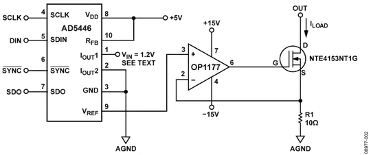

Here's an example circuit from Analog Devices: -
I don't see the two resistors and the capacitor in this schematic. If you were using a poor op-amp for this application (because of input offset voltages causing inaccuracies in the current) like the LM358 then you should consider using a bipolar transistor as shown in the data sheet on page 18: -
However, I believe it will work with a MOSFET providing you don't use a gate resistor (or a very small one). There are plenty of examples of the LM358 being used with MOSFETs without all the "extras": -

    This is not a simulation result but a real world measurement. I used my RIGOL scope to capture this. I only used LTspice to draw the simplified schematic the setup I used in the breadboard. – G36 Jun 08 '16 at 16:44
