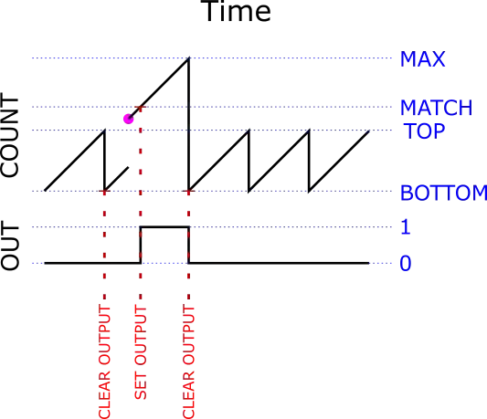

It is possible to generate a true fixed-length one-shot on AVR8 Timer hardware, but it is not straight forward.
The basic idea is to set the match value higher than the top value. If you then set the count to a value higher than the top, it will count up and hig the match exactly once before overflowing back to zero and then getting trapped down below match.
Using this technique it is actually possible to trigger a one-shot pulse as short as a single cycle. Additionaly, once started these one-shots will run deterministically to completion without any intervention whatsoever from the processor.
A full explanation and working code available here...
https://wp.josh.com/2015/03/12/avr-timer-based-one-shot-explained/

  • Definitely a cool concept, but I'm specifically looking for a hardware only solution. I may have found a way with the xmegaE and XCL, as the XCL natively supports a one-shot PWM that can be triggered by events. I will need to check on some of the configuration for it, and if it works I will answer my own question. – Brendan Simpson Jun 07 '16 at 19:09
  • You might be able to trigger the one-shot timer using and event from the comparitor. You might also be able to use the timer's input capture mode, but set it up so that it creates the pulse as a side effect. – bigjosh Jun 07 '16 at 19:22
