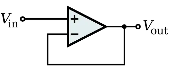

For the current output DAC it is the same as how you would want to measure a current in a circuit, you want to use an impedance as low as possible so that the current can flow through an impedance with the lowest voltage drop possible. Here you want to use a current input amplifier or a current to voltage converter. That can be a circuit as simple as:
This circuit has an input impedance of almost zero ohms. It multiplies the input current by the value of Rf and that will appear at the output as a voltage.
The trick with using such circuits is that it eliminates the influence of the (change in) output impedance of the R2R network. That way, you can forget about that output impedance also it does not introduce any errors anymore.

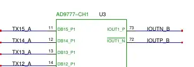

The AD9777 DAC's analog outputs get directly fed into the daughterboard connector:
DAC output
dboard connector
Then, on the daughterboard (let's talk about the WBX here, schematic):
WBX input stage
we see that
  • we match the 50 Ohm of the transmission line, which is necessary to get the most energy out of the DAC into our daughterboard (and corollary, the least reflections/distortions and
  • no active parts whatsoever involved in buffering what the DAC produces.
So, the DAC here runs at 100MS/s, which means that it's already wise to not think of the signal as "current flowing through a piece of metal", but to layout the differential lines from DAC to connector as microwave lines, i.e. microstrip etc, and commit to the fact that the fields around these conductors will carry the energy. In this scenario, capable opamps are hard to find, harder to get linear and even harder to get linear enough not to waste expensive DAC bits.
Of course, a DAC for these rates is specced with an output impedance that allows for correct transmission line impedance and termination impedance design. Which also means that for the 50 Ohm termination used here, Analog guarantees driving capabilities. From the AD9777 datasheet, p. 46:
Note that the output impedance of the AD9777 DAC itself is greater than 100 kΩ and typically has no effect on the impedance of the equivalent output circuit.

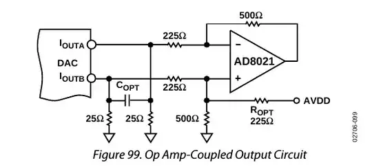

hence, we're pretty much in the case where "ok, you've got a sink impedance in the range of 100Ω, but the source impedance is much much higher, so don't you worry". Of course, p. 47 also explains how you can use an Opamp as output buffer:
Opamp output stage
Yet the text mentions explicitly the disadvantages and design restrictions this has:
The common-mode (and second-order distortion) rejection of this configuration is typically determined by the resistor matching. The op amp used must operate from a dual supply since its output is approximately ±1.0 V. A high speed amplifier, such as the AD8021, capable of preserving the differential performance of the AD9777 while meeting other system level objectives (for example, cost, power) is recommended.
Since Opamps are never perfect, you infer a lot of additional problems. Just think about parasitic capacitance in the feedback line, inclucing the 500 Ohm resistor, or the fact that resistors and package pins have inductance, that change the phase of a signal depending on the signal's frequency... suddenly, your broadband DAC has a less-than-flat buffer, and changing that might not be trivial, lest you reduce the bandwidth to something manageable.
