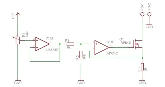

I got a great source for you, from Dave again! Here is the EEVblog #102 - DIY Constant Current Dummy Load for Power Supply and Battery Testing. And here is some info from that:
The circuit uses two OP-AMPs to set the constant current.
The first OP-AMP (IC1A), is configured as a voltage follower. What it does is; it takes the voltage at its non-inverting pin (pin 3) and shows it in its output (pin 1). This configuration is used because of its very high input impedance and very low output impedance.
Second OP-AMP (IC1B), is configured as a voltage follower too, however in the negative feedback there is Q1. So in this case (as its general behavior), OP-AMP will try to equalize the voltages in its non-inverting and inverting inputs (pin 5 and 6). In order to do this, OP-AMP will do whatever it can do with its output. So, in the end, voltage at pin 5 and pin 6 are going to be equal.
Saying that they are equal, let's continue. Upper pin of R3 is connected to the inverting pin of the second OP-AMP (IC1B:6). Lower pin of R3 is connected to the ground. So, voltage across R3 is equal to the voltage at pin 6, which is equal to the voltage at pin 5.
Let's say we have 3V at the output of IC1A. We will have a voltage of 1.5V at the non-inverting terminal of IC1B (pin 5), because of the voltage divider resistors R1 and R2. The voltage at IC1B:5 is going to be equal to IC1B:6 and that will be equal to R3.
With the ohm's law:
V=I*R
1.5 = I * 1
I = 1.5
So, as you see, voltage across R3 is equal to the current going through it which means that the current you are sinking from PS-1 pin which is connected to the battery or power-supply you want to test.
Let's say you want to have 1.2 A from your battery, then you will set your pin 5 to 1.2 V and that means pin 3 to 2.4 V.
To conclude, we can say that the voltage you set with your potentiometer (R4), is going to be the constant current source value.
This is my first time drawing a schematic with Eagle, if I've made a mistake, I'm sorry.
