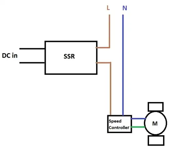

Figure 1.
I have the above mechanism, where I control a single-phase fan motor's switch. I mean instead of a mechanical switch, an AC/DC SSR is switching ON or OFF from a remote place by a constant DC input (DC in in figure, 10V or zero). When the SSR is ON, it will stay ON for long time like an hour or more. I mean it is not for speed controlling itself, it should act just to turn on the fan or turn off. The speed controller in the figure is an AC phase controlled speed controller(like a dimmer for inductive loads).
Here is the speed controller regarding the above figure: http://uk.rs-online.com/web/p/fan-speed-controllers/6685345/
As you see in my illustration when the SSR is ON, the hot line is connected to the speed controller. The fan speed is controlled via the poti knob of the speed controller manually.
The system above works for tests until now with the following SSR (Of course I cannot see whether there are current spikes or surges during each switching). Here is the SSR with zero crossing I have and use currently: http://uk.rs-online.com/web/p/solid-state-relays/2181959/?origin=PSF_428032|alt

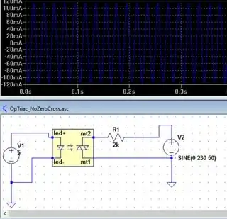

And below is an opto-triac this time with no zero crossing and DC in is always ON again:
Figure 3.
As you see above the opto-triac again fires at each zero crossing. What is going on here? It is not random.

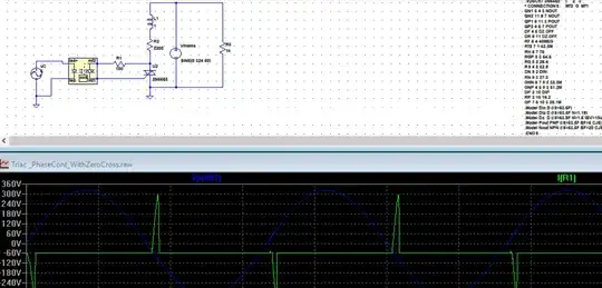

And here an opto-coupler with zero-crossing "with an inductive load":
Figure 5.

In your Figure 2 the DC is on all the time. As the AC voltage across the U2 rises the zero-cross circuit hasn't shut off the trigger yet. The blue trace shows the current into triac U2. Once it reaches the trigger value the triac switches on, the voltage across it drops to (almost) zero so the trigger current drops to zero. The triac keeps on conducting as is its nature.
In your Figure 3 the triac turns on as soon as possible after the zero cross. It's pretty much the same as Figure 2.
In your Figure 4 I can't make out where V[n002] is referenced but it's obviously out of phase with the voltage across the triac as the current through R1 is proportional to that.
Again, I'm not sure what you're showing in the Figure 5 trace.

If you were attempting to create an additional speed control with your SSR plus the ebmpapst speed controller box, then you might have a problem.
HOWEVER you are using your SSR only as an ON/OFF switch. So none of the warnings in those sources apply specifically to YOUR circuit. But congratulations for doing due diligence and investigating possible problems. Kudos.
You can use EITHER type of SSR (Zero-Crossing or Random-Fire) because you are implementing only a "static" ON/OFF function. The Zero-Crossing SSRs seem much more readily available than the Random-Fire kind.
The Zero-Crossing SSRs have extra circuitry which "delays" your trigger signal until the NEXT zero-crossing. Otherwise they would fire ANYWHERE, even in the middle of the wave. (Which is what "Random-Fire" means). We would want to use "Random-Fire" SSRs where we were doing something like incandescent lamp dimming etc.
When you apply a constant gate signal to the SCR it simply "stays on" through all the zero crossings. In one sense, you could say that it "fires" again at every zero-crossing, but in fact it makes no difference one way or the other.
